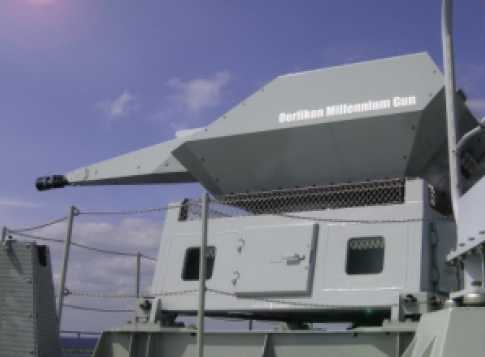

35 mm Millennium on Danish command and support ship Absalon
Photograph copyrighted by Johnny E. Balsved of Danish Naval History and used here by his kind permission
Production version of the 35 mm/1000 Millennium Naval Gun System (GDM-008)
Photograph copyrighted by Oerlikon Contraves AG

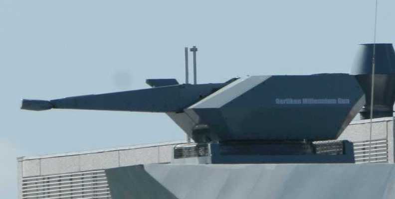

Skyshield, a land-based version of the 35 mm/1000

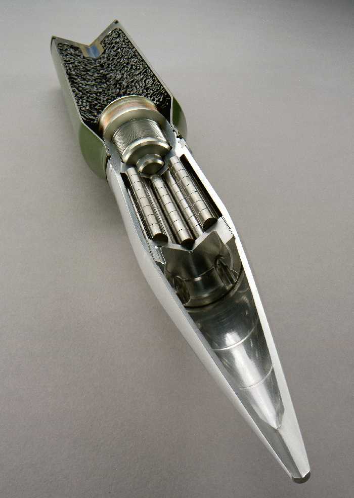

Cutaway of 35 mm AHEAD projectile
Sub-projectiles are stacked in 8 layers with 19 sub-projectiles in each layer

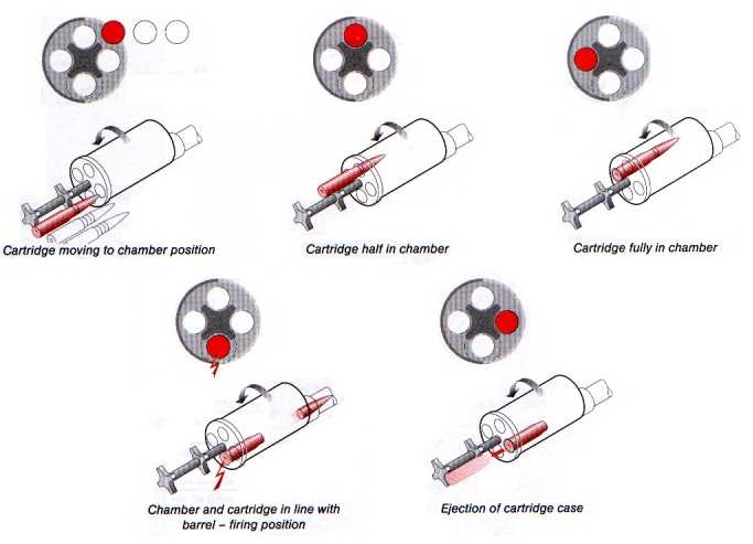

Operation of 35 mm/1000 KDG Revolver Cannon
Note that the "revolver" portion must mate tightly with the start of the barrel in order to prevent escape of propellant gasses
Image copyrighted by Oerlikon Contraves AG

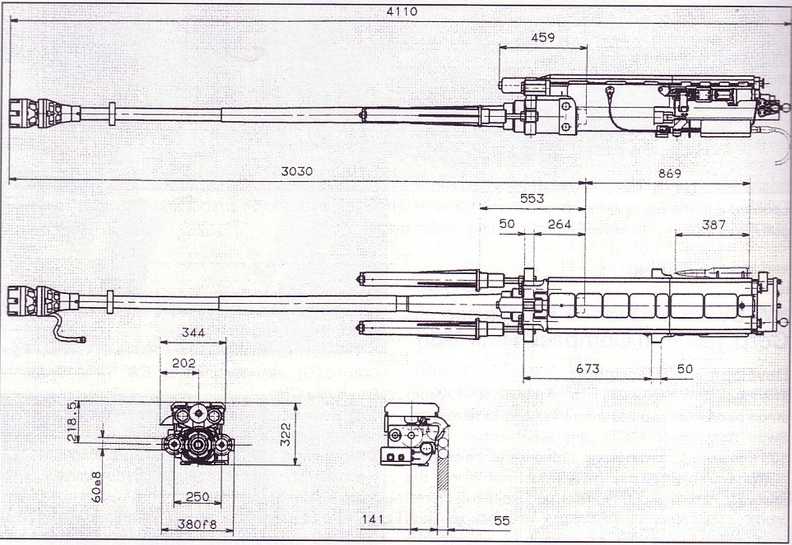

35 mm/1000 Dimensional Sketch
Sketch copyrighted by Oerlikon Contraves AG
