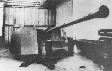

Gas-operated, air-cooled automatic gun developed for both land and naval use.  Only two prototypes were completed before the end of World War II.  Interesting in that no alloy steels were to be used in its construction, a reflection of the growing shortages in Germany as World War II neared its end.
Used a five-round ammunition clip and the gun fired with the breech locked as it moved forward from recoil.
One of the two completed prototypes
Picture copyrighted by M.J. Whitley
