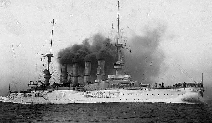

SMS Scharnhorst
The 15 cm (5.9") guns are in the hull casemates

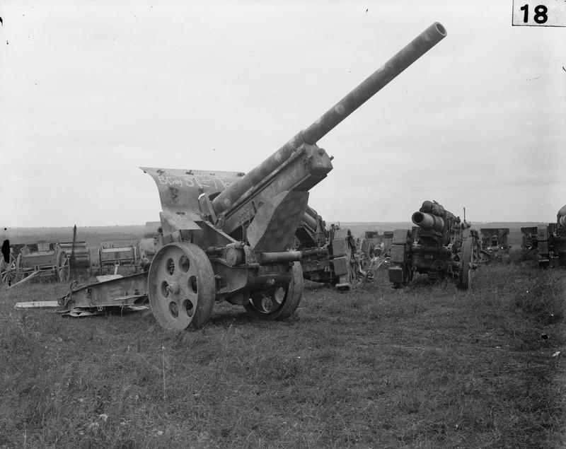

15 cm L40 gun being used as Army Artillery during World War I
IWM Photograph Q 35114
