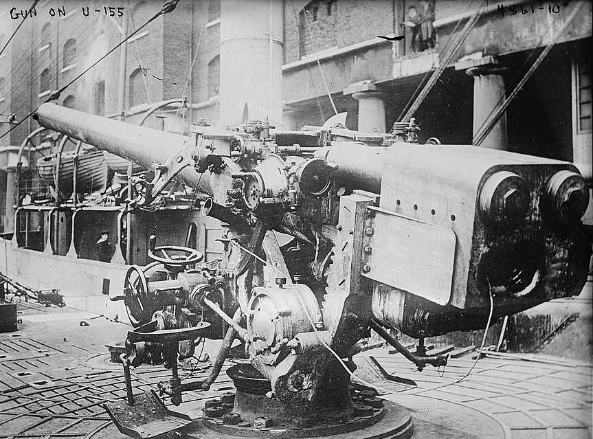

15 cm Ubts + Tbts KL/45 on U155 about 1918
Bain News Service Photograph
Library of Congress Photograph ID LC-DIG-ggbain-28410

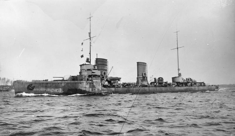

Destroyer V116
Post-war, this became the Italian Premuda
IWM photograph Q 50985
