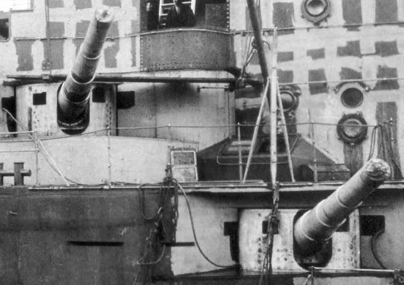

Pre-dreadnought Hessen about 1930
The 17 cm guns are in the amidships turrets and casemate emplacements

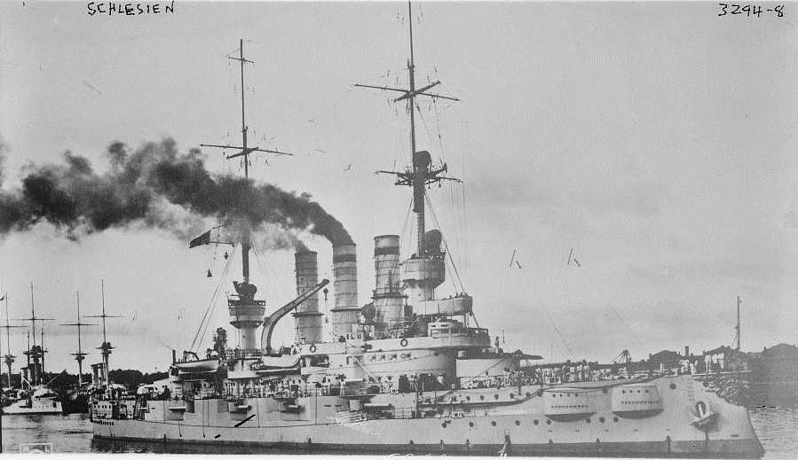

Schlesien showing her broadside 17 cm guns
Bain News Service Photograph
Library of Congress Photograph ID LC-DIG-ggbain-04269

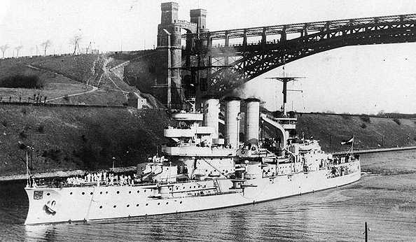

Two 17 cm/40 (6.75") guns on SMS Deutschland
Picture courtesy of Peter Lienau
