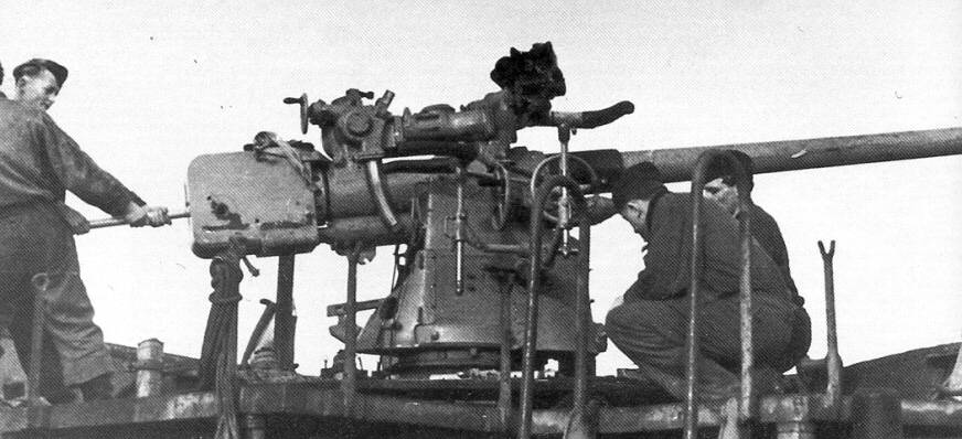

8.8 cm/45 SK C/35 mounted on a U-boat
Photograph courtesy of Peter Lienau

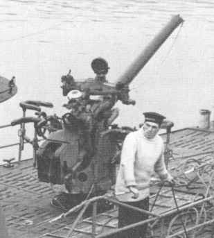

8.8 cm/45 SK C/35 on U570 following her capture by the British in 1941

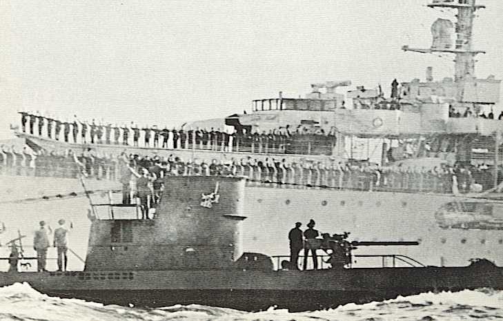

8.8 cm/45 SK C/35 Deck Gun on U47
In the background is the light cruiser Emden
