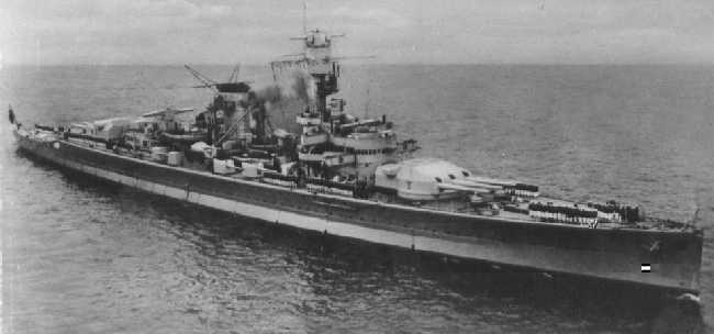

Lützow (ex-Deutschland)
The 8.8 cm guns are amidships alongside the stack
