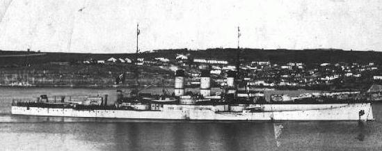

Battleship Roma about 1910
12" (30.5 cm) guns are in single turrets on the bow and stern
