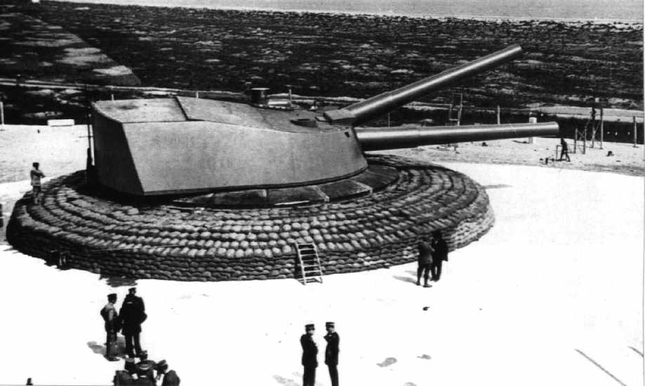

Battery Amalfi/S.Panagia
Ufficio Storico Marina Militare (USMM) Photograph

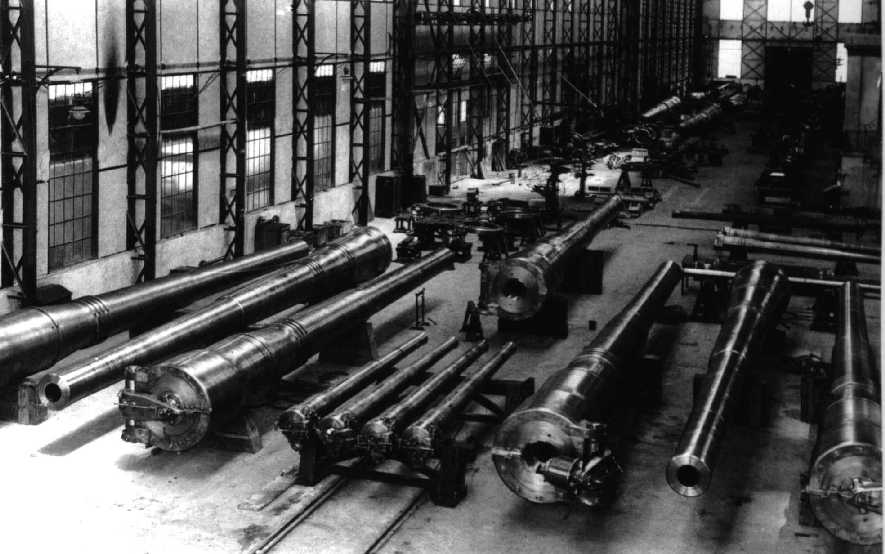

381 mm/40 (15") guns under construction at the Ansaldo Works
The heavy box is apparently a counter weight
Photograph courtesy of Eugenio Vajna

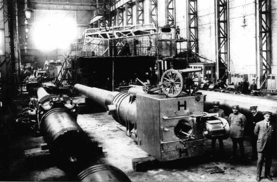

381 mm/40 (15") and smaller guns under construction at the Schneider-Ansaldo Works
