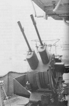

This gun was air cooled and gas operated and seems to have been fairly efficient.  It was derived from the 13.2 mm (0.52") M1931.  Considered to have been a good weapon, although the low magazine capacity of 12 rounds meant frequent stoppages for change outs.  An unusual feature was that the spent round was reinserted into the magazine.
Another 20 mm weapon used by the Italians during World War II was the 20 mm/70 built by Scotti-Isotta Fraschini.  This was used on the twin RM1939 mounting and a disappearing submarine mounting.  This weapon had similar performance to the Breda.
20 mm/65 Breda guns in Twin RM1935 mounting on a MTB
Photograph copyrighted by Elio Andò

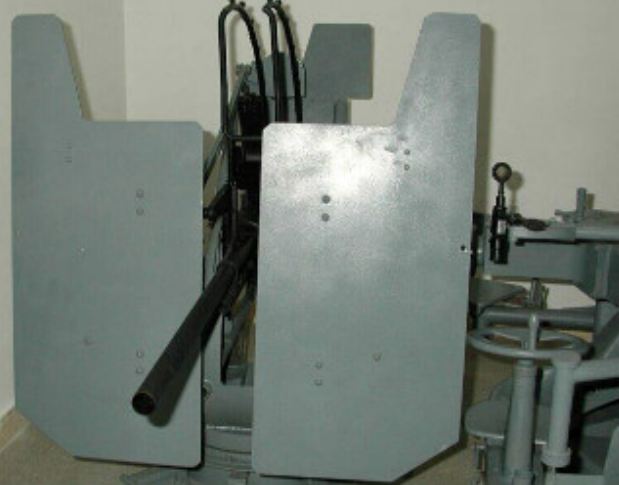

1) Model 1935 was a twin mount with a stabilized line of sight.  The left gun was mounted diagonally above the right gun (see picture above).
2) Model 1939 was a little-used single mounting.
3) Model 1940 was a free-swinging single mounting widely used on smaller ships.

21 September 2008 - Benchmark
23 September 2012 - Added picture of museum gun
