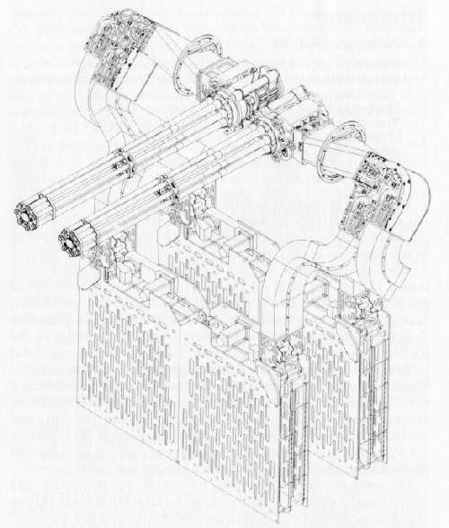

Twin 25 mm KBD guns of a Myriad mounting, showing the dual ammunition feeds
Sketch copyrighted by OTO-Melara
