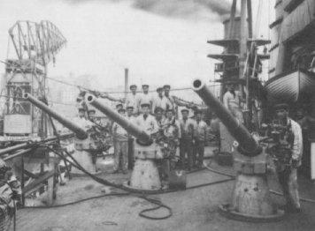

3"/50 (7.62 cm) guns on MM Caio Duilio
Photograph copyrighted by Giorgio Giorgerini

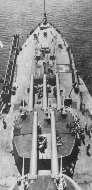

Forecastle of MM Andrea Doria as viewed from the bridge about 1918
Note the 3"/50 (7.62 cm) anti-torpedo boat guns on both turrets.  In my estimation, this indicates that "B" turret, although in a "superfiring" position, could not actually fire directly over "A" turret, a limitation which was typical of British-designed mountings of the time.
