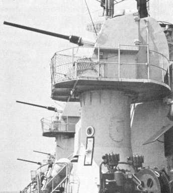

An OTO-Melara design, this automatic gun was used on Italian ships during the 1960s.  The barrel used a water-spray system for cooling.  The mounting is electrically powered and has a water-tight, splinter-proof shield.

76 mm/62 M.M.I. Mountings

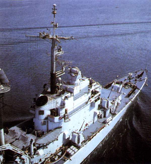

76 mm/62 M.M.I on Andrea Doria
Marina Militare Photograph

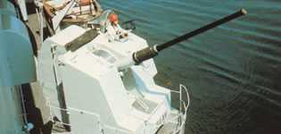

76 mm/62 M.M.I.
Photograph copyrighted by OTO-Melara
