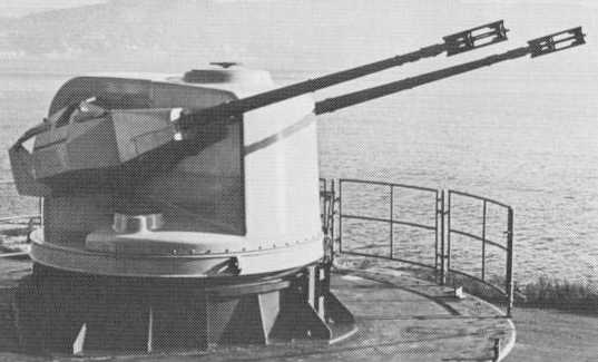

![]() 35 mm/90 KDC gun in Oerlikon GDM-A Twin
Mounting

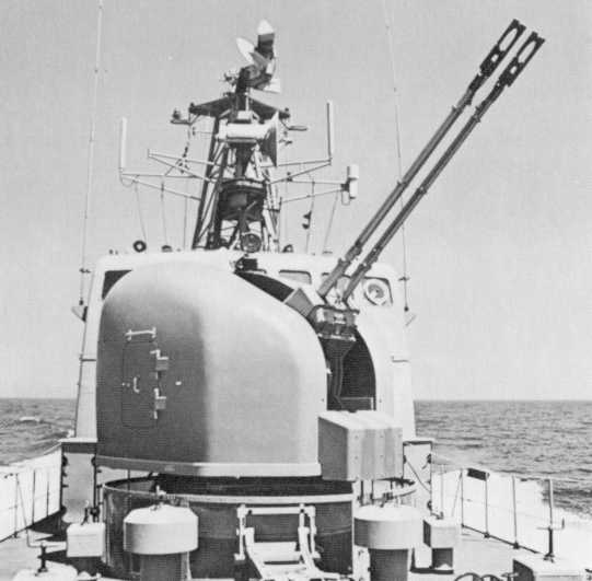

Mounting

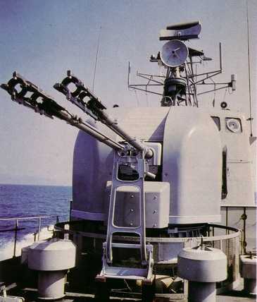

![]() 35 mm/90 KDC gun in OTO-Melara GDM-C Twin
Mounting

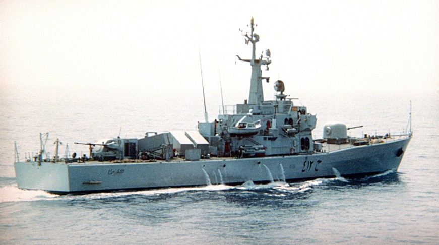

![]() 35 mm/90 on Libyan missile corvette Assad
in July 1983

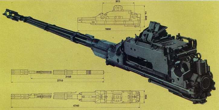

![]() 35 mm KDC Gun
Designation | Gun: Oerlikon 35 mm/90 KDC |
Ship Class Used On | Iran: Mark 7 frigate
Greece: Missile Boats Japan: Patrol Boats |
Date Of Design | about 1965 |
Date In Service | 1972 |
Gun Weight | N/A |
Gun Length oa | 186.6 in (4.740 m) |
Bore Length | Including muzzle break: 146.1 in
(3.710 m)
Without muzzle break: 138.2 in (3.510 m) |
Rifling Length | N/A |
Grooves | N/A |
Lands | N/A |
Twist | N/A |
Chamber Volume | N/A |
Rate Of Fire | 550 rounds per minute per gun cyclic |
Note: Weapons are completely interchangeable and can be assembled for left or right feed. |
