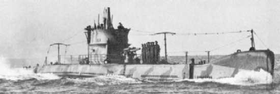

102 mm gun on unidentified "Squalo" or "Bandiera" class submarine

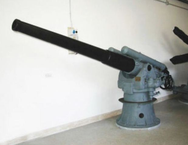

102 mm/35 gun formerly on Submarine Chaser Albatros
