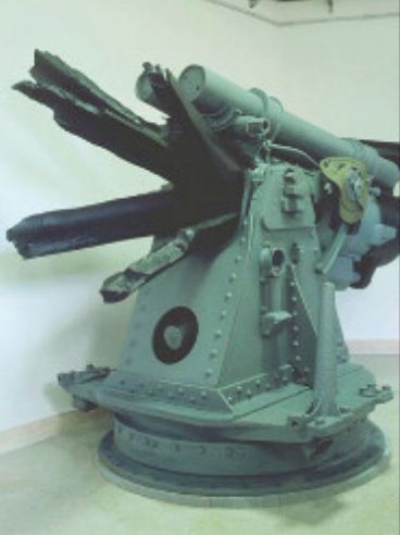

102 mm/45 that exploded in August 1927 during test shoots
