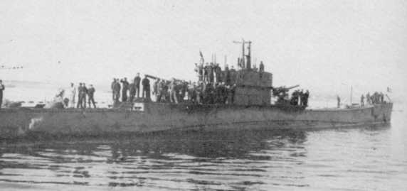

120 mm guns on Minelayer Submarine Pietro Micca
