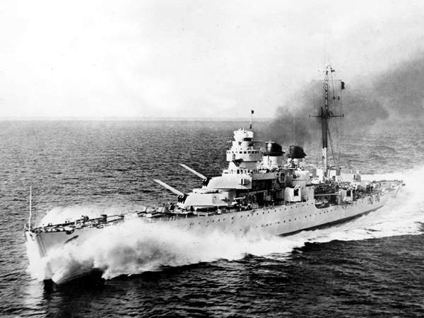

Light Cruiser Luigi di Savoia Duca degli Abruzzi
(Name was usually shortened to just "Abruzzi")
Picture copyrighted by M.J. Whitley

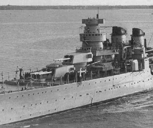

Nice picture of Abruzzi at speed
The circular objects under the gun barrels are the ejector ports for the spent cartridge cases

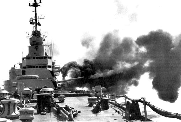

Abruzzi firing her guns in the post-war period
Note the radar antenna on the foremast

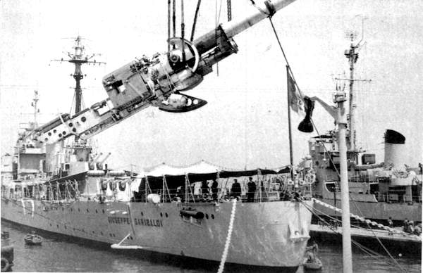

Giuseppe Garibaldi having a 152 mm gun removed in the late 1950s during her conversion to a missile cruiser
The case ejector tube under the gunbarrel can be clearly seen in this photograph
