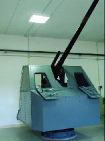

23 September 2012 - Added picture of Museum gun
