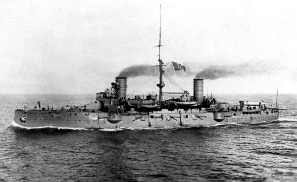

Italian Giuseppe Garibaldi
8"/45 (20.3 cm) in twin stern turret
Marina Militare Photograph

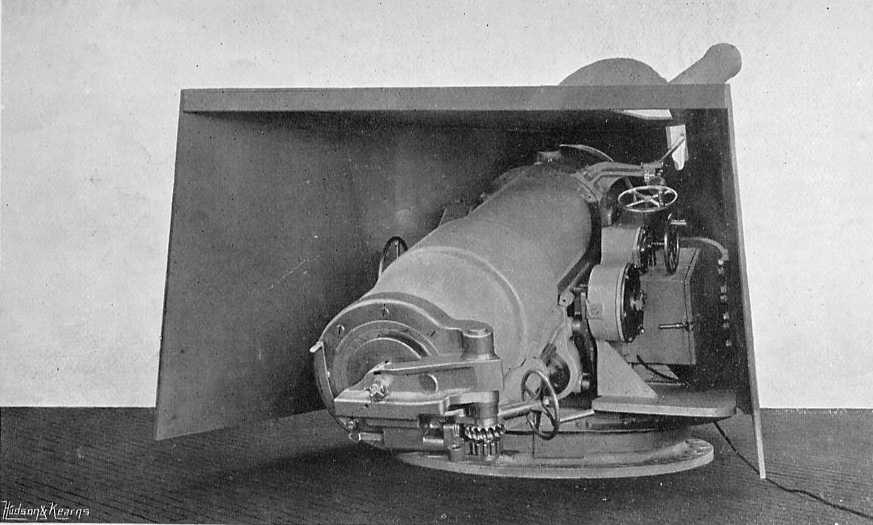

8"/45 (20.3 cm) gun under construction at the Elswick Works
Photograph courtesy of Dave Perkins
