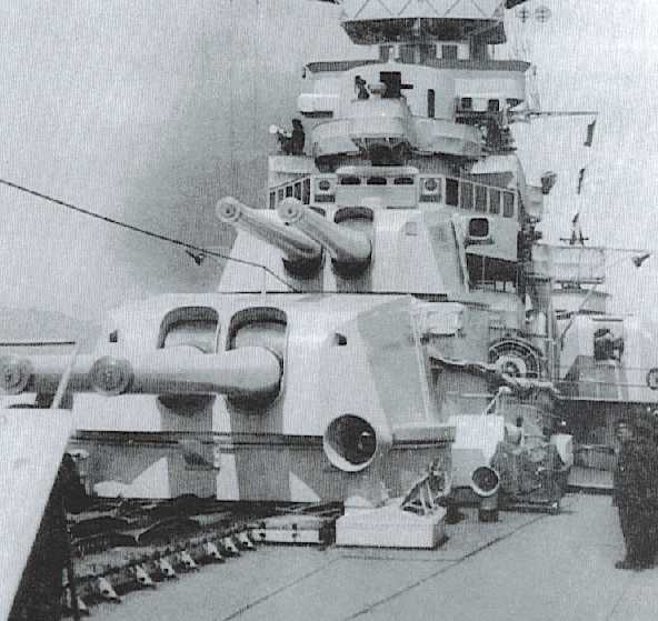

Bow turrets of Trieste shortly after commissioning
