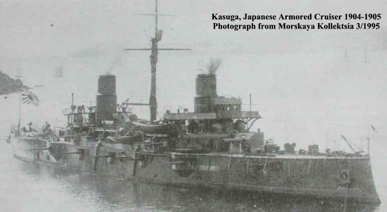

Japanese Armored Cruiser Kasuga
10"/40 (25.4 cm) EOC gun in bow mounting
Photograph courtesy of Steve Backer of Steel Navy

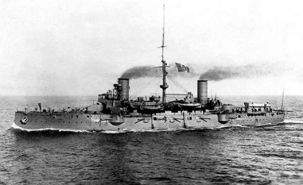

Italian Giuseppe Garibaldi
Marina Militare Photograph

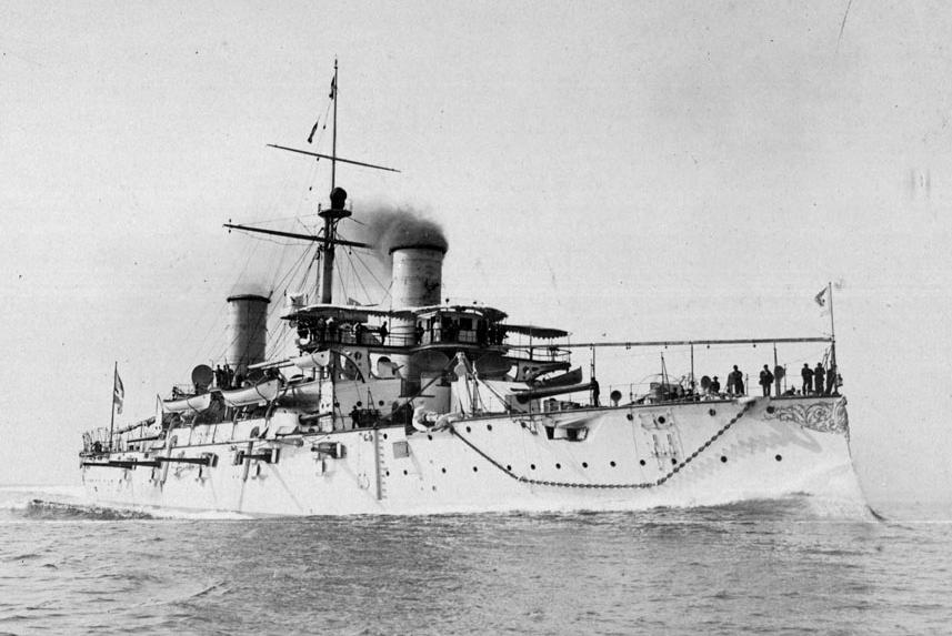

Argentina Cruiser Belgrano
Photograph from the collection of Carlos Mey and used here by his kind permission
