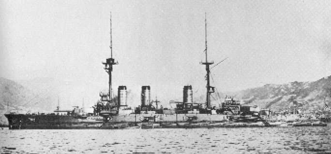

Aki in December 1915
The 10" (25 cm) guns were in the amidships turrets
BfZ Photograph
See 4928
