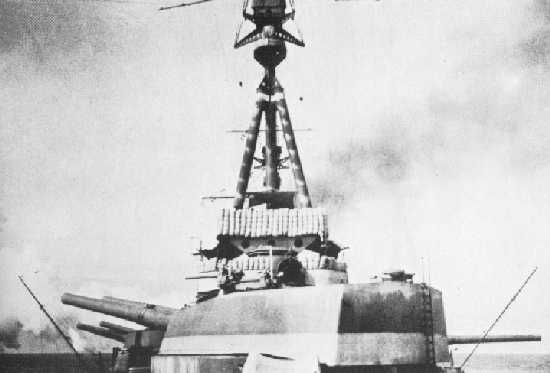

Kawachi about 1914
An interesting view that shows the bow 12"/50 (30.5 cm) turret and some of the 12"/45 (30.5 cm) wing turrets
BfZ Photograph
