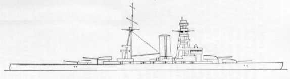

![]() Sketch of "13" from "Japanese Warships of World War II" by A.J. Watts |
Designation | 46 cm/45 5th Year Type (Model 1916) |
Ship Class Used On | "13" Class Battleships (Battleships 39-42, also known as Battlecruisers 13-16) |
