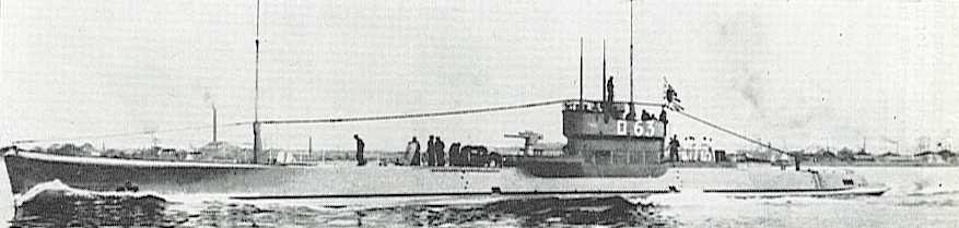

8 cm/25 (3.0") Short Gun on RO63 at Kobe in December 1924
