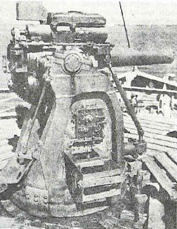

Similar in concept to the 20 cm/12 (8") Short Gun, this weapon was intended for lighter merchant vessels.  Also used in coastal defense batteries.  Monobloc construction with a screw breech.
Actual bore size was 12.0 cm (4.724").
12 cm/12 (4.7") gun in coastal defense battery
