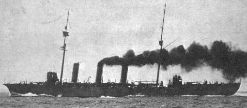

Cruiser Tone on trials 13 April 1910
6" (15.2 cm) guns are on the forecastle and stern
Photograph copyrighted by Fukui Shizuo
