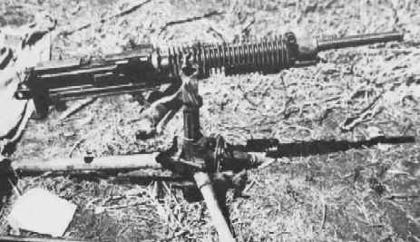

This was a Japanese version of the Hotchkiss 6.5 mm Model 1900 machine gun, which had proved very successful during the Russo-Japanese War.  The Japanese version was adopted by the Army in 1914 as the Type 3 Kikanhô (or Kikanjû) with the Navy following on 6 December 1916.  The Navy designated this weapon as 3rd Year Type 6.5-mm Kihô (machine gun).
The Japanese version had a slightly modified ejector mechanism and additional cooling fins on the barrel and was chambered to use standard 6.5 mm Japanese rifle cartridges.  Magazines were metal strips holding 30 rounds each.
This gun was considered to be both strong and reliable, its main drawback being that the cartridges had to be oiled before firing.
