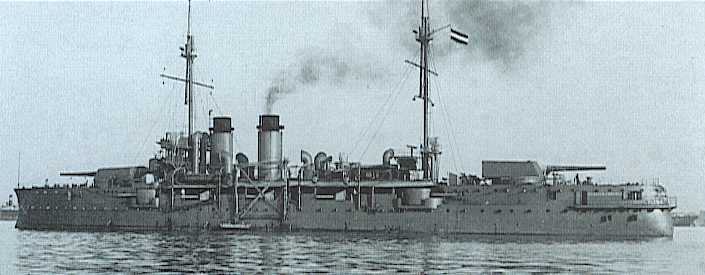

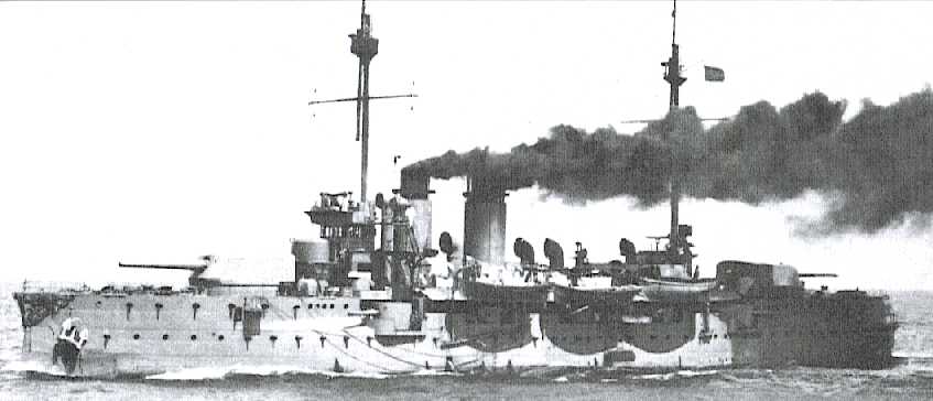

Possibly manufactured by Krupp and used on a Coastal Defense Ship.  Overall length was 42.16 calibers and it appears that the actual bore length was 39.58 calibers.
De Zeven Provinciën
Institute for Maritime History Photograph
De Zeven Provinciën
