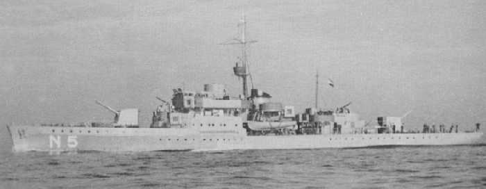

RNN Van Spejik after World War II
This ship served in the Kriegsmarine as K3 during World War II
