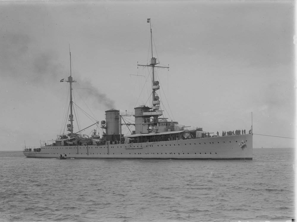

Light Cruiser RNN Java
State Library of Victoria Image H91.325/284

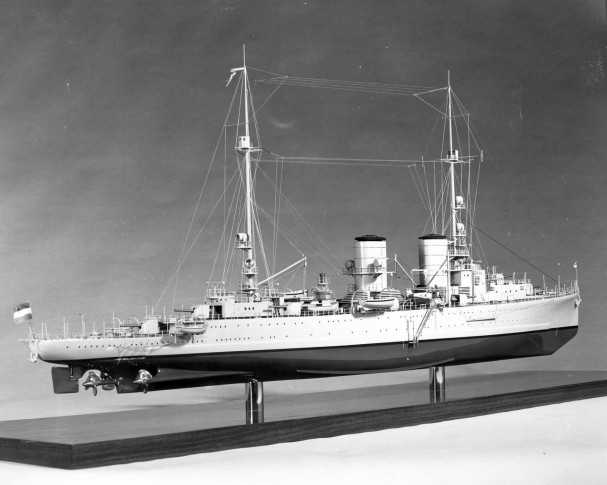

Model of RNN Java
Note that this was a triple-screw warship

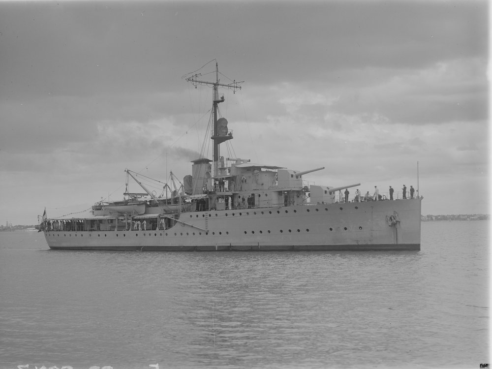

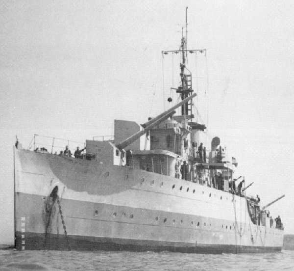

Sloop RNN Flores
Royal Netherlands Navy Photograph
RNN Flores pre-war in Australian waters
State Library of Victoria Image H91.325/272
