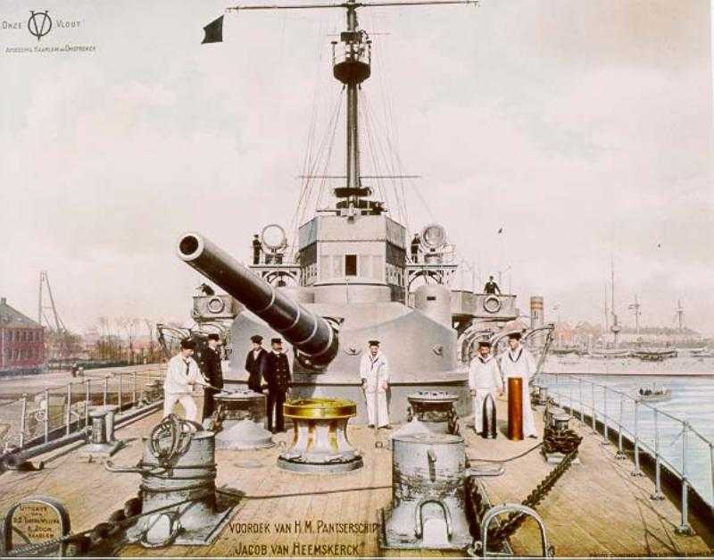

Colored postcard of Jacob van Heemskerck

02 June 2009 - Added picture of Jacob van Heemskerck
