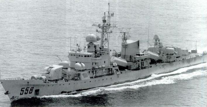

Chinese Frigate Zigong
Photograph copyrighted by Ships of the World
