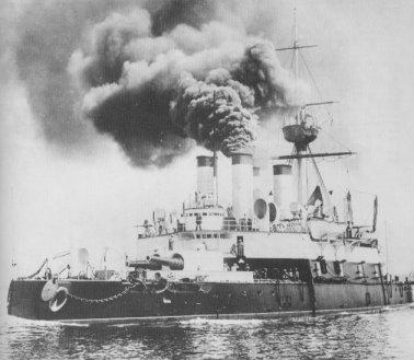

Russian pre-dreadnought Navarin
Photograph from "History of Russian/Soviet Battleships"
