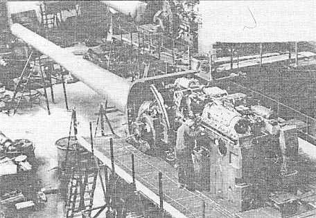

30.5 cm/62 (12") being assembled
Photograph from "Bastion" Magazine
