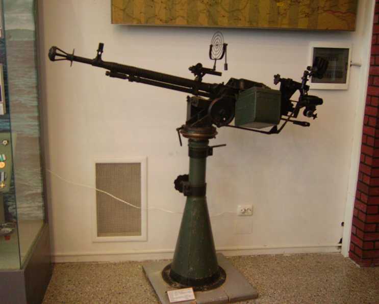

12.7 mm DShK on G-5 class torpedo boat
Soviet 12.7 mm DShK on a Naval Mounting
Central Museum of Armed Forces, Moscow, Russia
