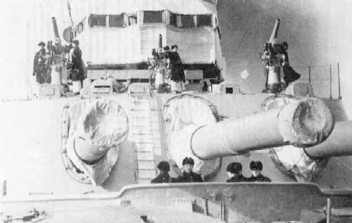

7.62 cm/30 (3") guns on top of battleship Marat turret in 1928
Photograph from "Last Giants of the Russian Imperial Fleet"

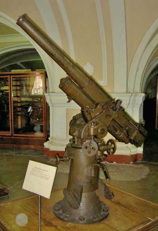

76.2 mm/30 Lender Gun now at Central Artillery Museum, St.Petersburg, Russia
