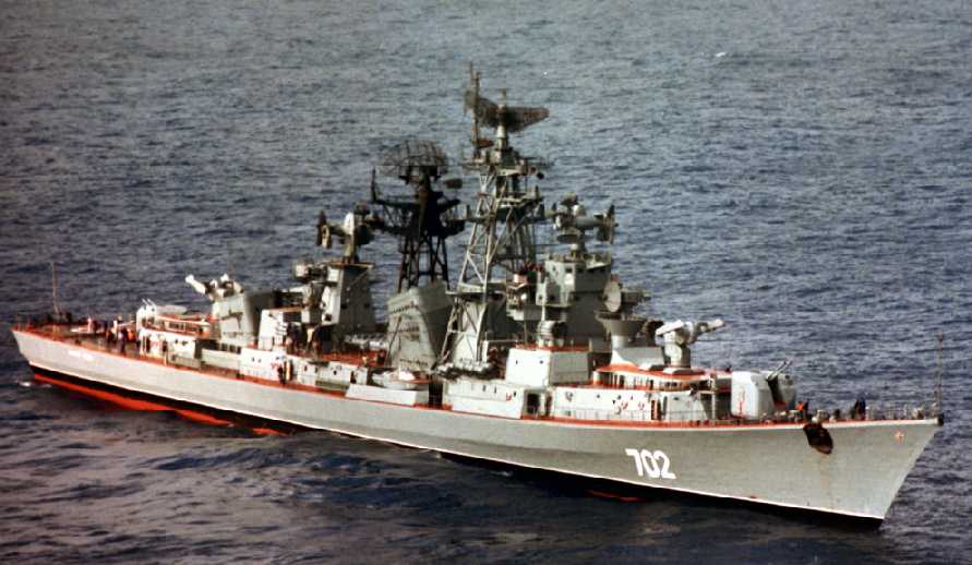

Krasny-Kavkaz, a Kashin Class guided missile destroyer, in 1985
U.S. Navy Photograph No. DN-SC-86-00469

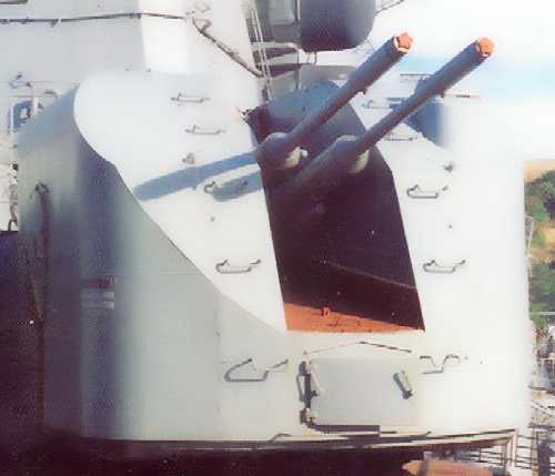

Close up of 76.2 mm (3") mounting
