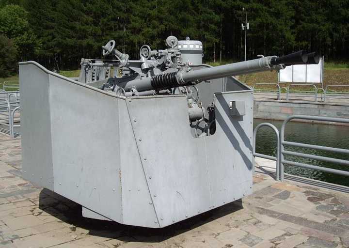

Twin 37 mm in V11 mounting now at Moscow Victory Park in Russia

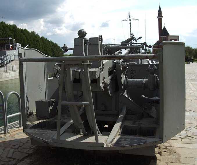

Rear view of same mounting now at Moscow Victory Park in Russia

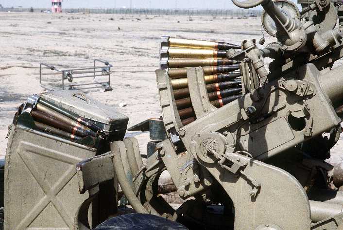

Iraqi Army 37 mm showing details of the ammunition feed and ready ammunition stowage in February 1991
U.S. Army Photograph No. DF-ST-92-08204
