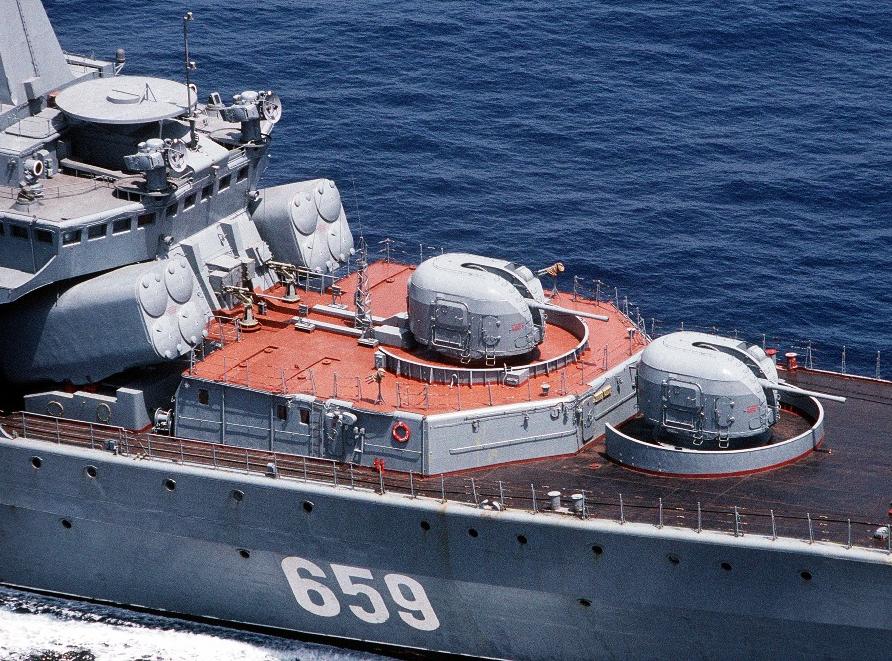

100 mm/70 guns on Vitse-Admiral Kulakov (DDG-659), a Udaloy class guided missile destroyer in June 1988
Missile launchers under the bridge are for SS-N 14 anti-ship missiles

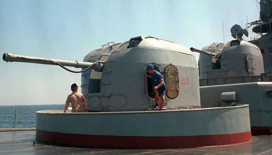

100 mm/70 guns on Admiral Vinogradov (BPK-554) in October 1992
U.S. Navy Photograph No. DN-SC-93-04774

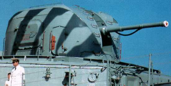

100 mm/70 gun on Udaloy class Destroyer
