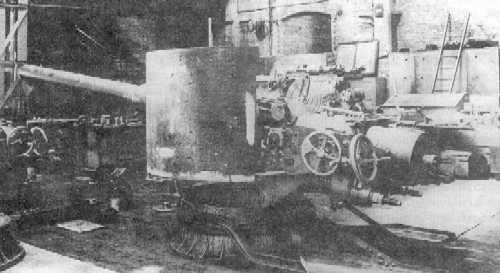

Casemate mount on Gangut class BB
Photograph from "History of Russian/Soviet Battleships"
