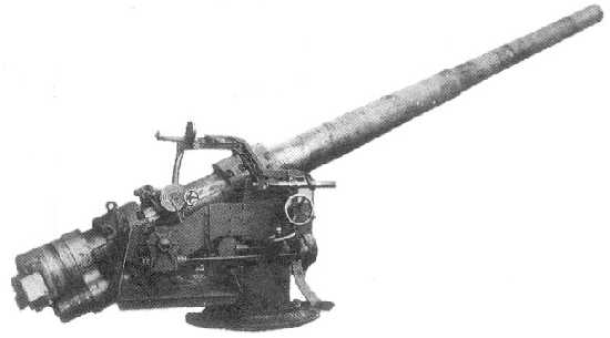

  The Pattern 1913 was the Russian produced version of this weapon.  The Mark A and Mark B versions were produced for Russia by the British firm of Vickers.  The Mark A was manufactured prior to World War I while the Mark B was manufactured during World War II.
This weapon was originally designed as a cartridge gun, but the Russian Navy wanted a cheaper and simpler design, so Obukhov modified the weapon to use bag ammunition with a Welin breech-block.  In 1913 the Obukhov factory received an order for 471 of these guns.  By 1917, 147 guns had been manufactured with the balance to be delivered in 1917-18.  However, due to the Russian Revolution, these remaining weapons were never completed.  In addition to the guns built by Obukhov, a further 100 guns were ordered from Vickers in 1913 with most of them being delivered by 1917.  The Royal Navy considered this weapon for arming DAMS during World War I, but decided against it as it would have added yet another medium-caliber weapon to the inventory.
The Russians used these guns to rearm some of the older protected cruisers, as secondary armament on Imperatrisa Maria class battleships and as main armament for the new Svetlana class light cruisers.  By 1917 the Naval Ministry had 117 guns on hand plus some additional guns used for coastal defense under army command.  During the Russian Civil War these guns armed many river gunboats and barges.
Redesigns during the 1920s and 1930s attempted to increase elevation, but these were not particularly successful and none were adopted for general service use.  However, in 1930 two mounts with +40 degree elevation were built for river monitor Udarny.  As of 1941, the Soviet Navy had over a hundred of these guns in service, with 21 in the Baltic Fleet, 7 in the Pacific Fleet, 64 in the Black Sea Fleet, 6 in the North Sea Fleet and 12 in the Amur Flotilla.
Vickers delivered 55 guns and 55 spare barrels for the Mark B during the latter half of World War II.  In addition, the USA supplied shrapnel rounds for these weapons during World War II.
The Mark A consisted of A tube, three B tubes to the muzzle, jacket and a small breech ring.  The breech bush holding the Welin breech block was screwed into the jacket.  The Pattern 1913 was to a similar design.  Mark B had a loose barrel, jacket and breech ring with breech bush and gun ring.

Designation Single Mounts
  Imperatritsa Maria (20), Diana (rearmed), Bogatyr (rearmed), Prut (rearmed), Khrabry (5), Grozyaschii:  N/A
Single Turret
  Monitor Udarny (2):  N/A
Weight 17.16 mt
Elevation Older mounts:  -5 / +20 degrees
Newer mounts:  -5 / +30 degrees
Udarny Turrets: -5/ +40 degrees
Rate of Elevation 4 degrees per second
Train 360 degrees possible (constrained by superstructure)
Rate of Train 4 degrees per second
Gun Recoil 16 in (40.6 cm)
Loading Angle Any
