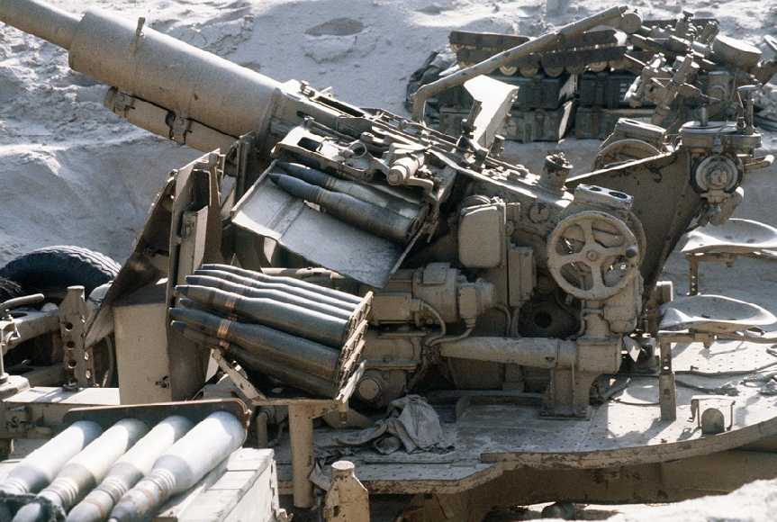

Iraqi 57 mm S-60 in February 1991
These weapons used the same clip-fed ammunition as did the ZIF-74
U.S. Army Photograph No. DM-ST-91-11947
