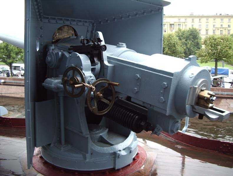

6"/45 (15.2 cm) Pattern 1892 gun on Protected Cruiser Avrora (Aurora), St. Petersburg, Russia

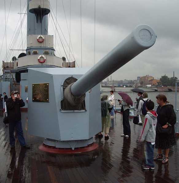

6"/45 (15.2 cm) Pattern 1892 bow gun on Protected Cruiser Avrora (Aurora), St. Petersburg, Russia

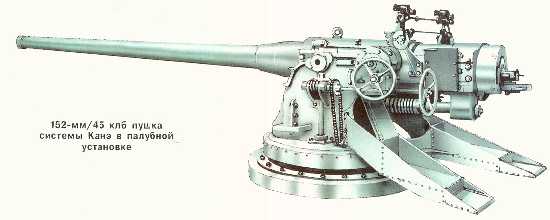

6"/45 (15.2 cm) Pattern 1892 in ship-deck mounting
