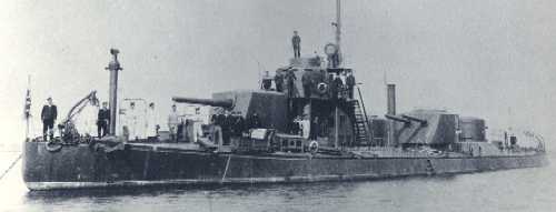

Schkval class Monitor
Photograph from Sudostroevie Magazine
