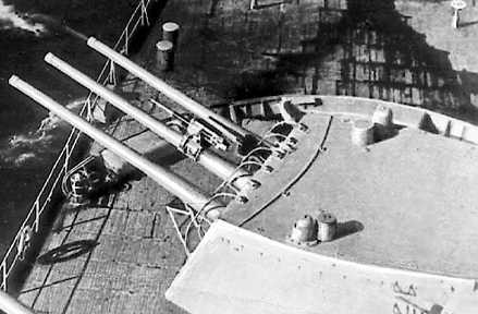

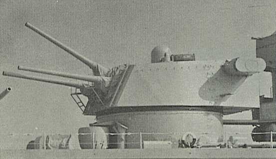

152 mm (6") Bow turret on Chapaev
Note the training gun on the center barrel
Note that the guns were individually sleeved
