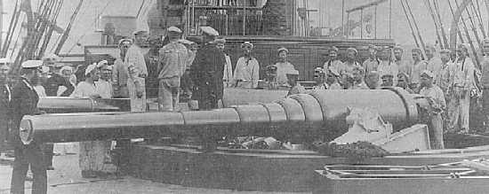

Aft barbette mount of the Russian armored cruiser Admiral Nakhimov
The built-up construction of these guns is obvious in this picture
Photograph from "Armored Cruiser Admiral Nakhimov"
