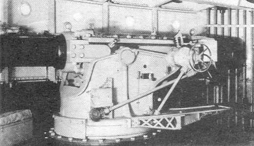

8"/45 (20.3 cm) Pattern 1892 in casemate mounting on Armored Cruiser Rossiya

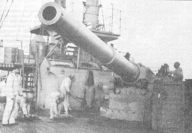

8"/45 (20.3 cm) gun on Armored Cruiser Bayan ca. 1917
