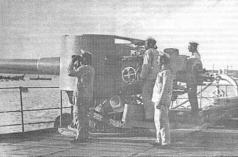

8"/50 (20.3 cm) deck gun on Siniop

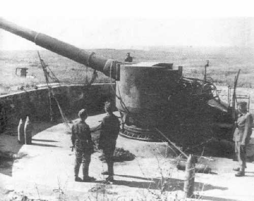

8"/50 (20.3 cm) Pattern 1905 in coastal defence mounting
This gun was in the #10 battery near Sevastopol in 1942
